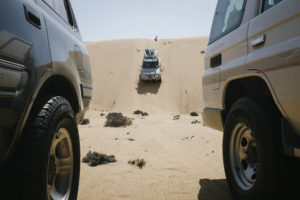

    A fully loaded 4×4 can tip over easily while sand driving across steep dunes. When driving up or down dunes, approach the obstacle square to the front of your vehicle. It is much more difficult to tip your vehicle over frontwards or backwards when compared to the sides.

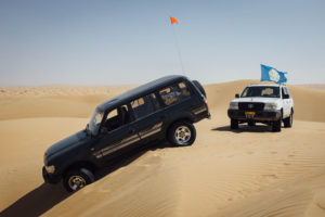

    Sand Driving TipsEventually you will need to stop while sand driving, and a little foresight will help you when it comes time to start driving again. Most likely after a few minutes of sand driving you will start to be able to feel which patches of sand are hard and soft. If no hard sand can be found, maneuver your vehicle to face down a small dune before you come to a full stop. When it comes time to start sand driving again, gravity will help you overcome getting bogged down.

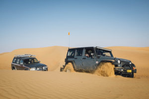

    When you start to get bogged down, get your right foot out of it! If you are not moving, spinning tires will only dig you a deeper hole to get out of. Don’t spin the tires, and instead employ sand driving tips 7, 9, and 10; keeping your revs low.

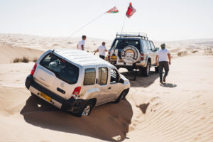

    When you get bogged down, hop out of the driver’s seat to assess the situation. Often times you can take your hand or shovel to push aside the pile of sand in front of or behind your wheels making your progress difficult. If you have not followed tip 8, you might have a bit more sand removal to do. Clear sand away from your axels, bumpers, or anything preventing you from freely moving.
  10. Reverse
    Getting bogged down is inevitable, and I like to say you’re not actually sand driving unless your getting stuck. The simplest way to get free from a bog down in soft sand is to reverse out. You know how the sand is behind you, you just compacted it with the weight of your 4×4, so take advantage of that. A super sand driving tip is to select normal/high 4×4 when reversing. Reverse gear is already very low and low 4×4 gears make this combination very low and slow. High 4×4 gears along with your reverse gear allow you to make a little more speed to keep up your momentum.
